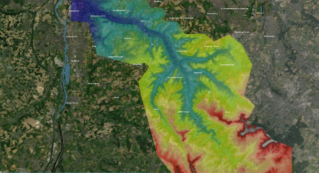

We started by generating a map of the complete Geul catchment area. The Geul is almost 60 kilometers in length with many more side streams. It starts in Belgium just below Aachen and has several smaller side rivers. The map generation is an automated process which uses public data sources to create a detailed project containing millions of GEO features:
Visualization of DEM in the Geul catchment area
  • Heightmap: AHN in the Netherlands, in Belgium the world elevation map from ESRI is used.
  • Buildings & Infrastructure: BGT, BAG, CBS, Top10NL, NBW in the Netherlands and OpenStreetMaps in Belgium.
  • Terrain: Rivers, crop fields, woodlands etc. from BGT, BRO, Top10NL , BRP in the Netherlands and again OpenStreetMap data for Belgium.
  • Hydraulic structures: e.g. culverts from the Waterschapshuis Information model.
Variables like ground infiltration speed or manning roughness values are determined based on geo information. For example a grid cell with cobblestone road (BGT, NBW) on sand (BRO) and some corn fields (BRP) on the side has a unique value.

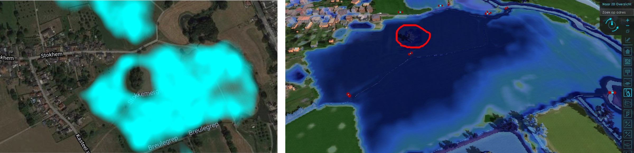

  • Flooding maps from satellite imagery. These can be very useful to check if the water was outside the river bedding. We used data from the Sentinel satellite provided via Deltares & Earth Engine.
Flooded field near Wijlre Left Sentinel Right Tygron, note that the Tree in the middle is not flooded in Sentinel image, red circle for Tygron, this is most likely due to woodland distortion, since the elevation below the tree is identical to the surrounding area.
  • We did however also find several places that were flooded according to the simulation but did not show up in the satellite imagery. This might be explained woodlands that distort the imagery or because the flooding is very short and the satellite was not in orbit at that moment? We investigated a few of the locations. For example restaurant The Geulhof near Meerssen did not show up on satellite imagery, but was actually flooded according to local newspaper 1Limburg.

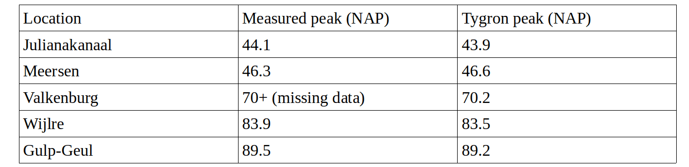

  • Water level (m) measurements from Waterstandlimburg. This website provides excellent water level measurements at 20+ point along the Geul and side streams.
These calculated values are all within a margin of +/-30cm from the measured data in the main Geul valley. Note that in many places like Valkenburg, the Geul reached more then 300cm above the regular level.
We did see some bigger NAP differences near the Belgium border but this is related to how the river bedding is setup, looking at the relative level increase (max level – bedding) Slenaken and Cottessen are also within 30cm margin.

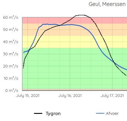

  • Finally maybe the best validation is done on the measured flow (m3/sec) at the exit point of the Geul near Meerssen.
Comparing the flow over time you see the same trend line, Tygron starts lower on the first day and compensates on the second. I have tested a few variables and I think the most likely explanation is inaccurate rainfall data. But overall the total sum of water (area below graphs) that flows trough the Geul is within a ~10% margin of what was measured.

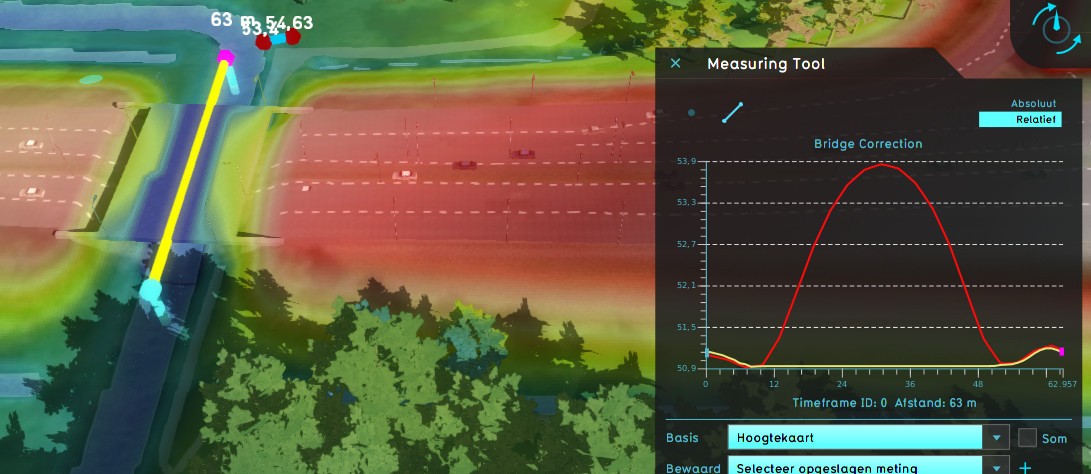

Automated Bridge correction, lowers AHN elevation 3 meters below the bridge
  • Bridges are loaded from the BGT data as buildings and the water model uses terrain height below the bridge so the water can flow under it. However we encountered several places where the terrain elevation (not surface) has a bump below bridges, thus jamming the water flow. To resolve this we added a new advanced option that lowers the height map of the river below bridges to the lowest point under or near the entrance of the bridge. In most cases this provides a very stable flow under bridges and if needed users can still upload more detailed river bedding heightmaps.
