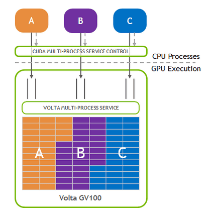

2: Multi-Process Service: Using the NVIDIA Multi-Process Service (MPS) a hardware based GPU scheduler is also activated. This scheduler maps the two contexts into a single one that will then be optimally executed by the GPU’s processing cores. This also means no overhead due to context switching.
Figure: MPS Scheduler service running 3 jobs
