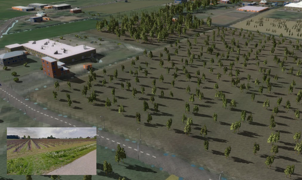

BRP Crops influences terrain roughness near breach

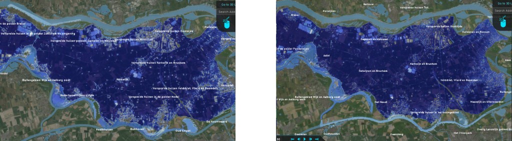

First we compared the results of the 5x5m model with results from the previous 1x1m run. Here you can see that on the larger rural planes the flow pattern is almost identical. Also the time it takes for full flooding of the polder and final water depth is roughly the same.
Flow pattern for 5m and 1m
Depth after 4 days at 5m and 1m

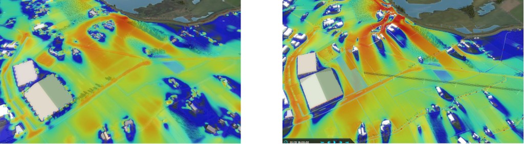

Between buildings the 5x5m model has less flow. Whether or not this is a problem depends on the situation. When the water mainly flows through small streets this is a problem, however in the Bommelerwaard case most area is flat rural and the water can easily flow around and will eventually “surround” villages. The TU Delft study also confirmed that different grid sizes does not severely impact the amount of expected casualties in this specific case.
In case of a large metropolis getting flooded, I do expect that there will be a significant impact on e.g. the arrival time!
Breach flow pattern 5m and 1m

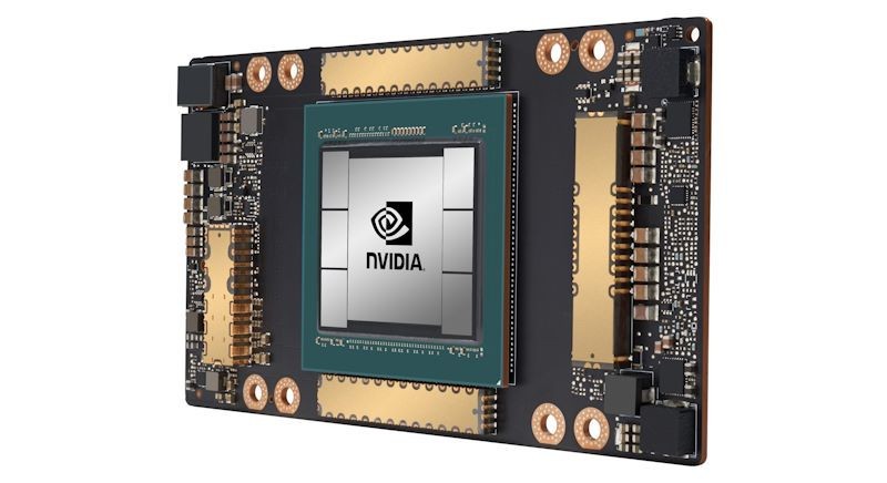

2 Hardware: GPU power increases steadily every year and recently we have started testing the next generation Ampere GPU’s from NVIDIA. From these tests we can conclude:
  • Ampere is out-of-the-box 2x faster then the previous Volta generation for Tygron. This mainly due to; faster memory, faster interconnect NVLINK, improved management and a much bigger L2 cache. Also double precision floating point (64 bit) operations have increased by a factor of 2.5.
  • Ampere now also supports 64 bit Tensor Cores. Using these special cores you can do matrix multiplications in one single call. This does require however that we rewrite part of the algorithms, but if successful might also yield an additional ~2x speed increase.
  • At the moment the Ampere GPU is for small scale testing only. Later this year I hope to re-run of the Bommelerwaard and we also expect to start using them in the production environment (available to all users).
