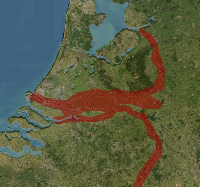

This resulted in an experiment to create a map the size of the Netherlands with all major rivers (Rhine, Meuse and IJssel) interacting with each other in a single simulation model. The model contains 2.000.000.000 grid cells and hundreds of kilometers of river. Calculating River Deltas at such high detail seemed impossible only a few years ago.
Red Area has a higher level of detail

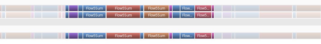

  • Graphs: Large simulations do not only contain a large amount of grid cells but due to the explicit nature of our parallel calculation model also a many time-steps to comply with the CFL condition. A typical simulation can have millions of time-steps with for each step 80+ kernel launches over multiple GPU’s. However each kernel launch results in a small overhead to startup. To make this more efficient we now use CUDA Graphs which was recently introduced by NVIDIA. Graphs are specifically designed for time-step based simulations and takeaway most of this overhead.
  • Streaming launches: To make the graphs even more efficient we launch batches of 10.000 graphs into a CUDA Stream. When the simulation reaches the endpoint we stop launching new graphs. When the endpoint is halfway a 10.000 batch, the kernels are notified and just do nothing. The overhead of some unused kernel launches is far less than waiting for each single graph to execute.
Graph launches a set of kernels into a stream

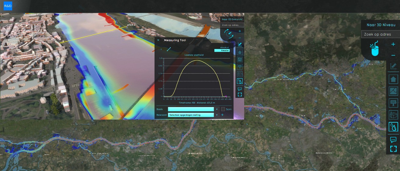

The major river experiment worked, but also resulted in many new challenges. Water flows through the rivers, but we did not jet include all the detail about the river weirs in the entire Netherlands. But also for example the amount of zoom levels in the Tygron client software was inadequate and the memory requirements for the client application (not server cloud) are very high.
Waal river speed with detailed inset from same project
